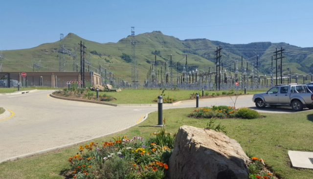

Eskom recently synchronised the final unit of its Ingula Pumped Storage Scheme, which is located on the cross-border of the Free State and KwaZulu-Natal.
Eskom said Unit 3 was previously synchronised to the national grid on 6 March 2016 and supported the grid until 6 April 2016 when an electrical incident occurred.

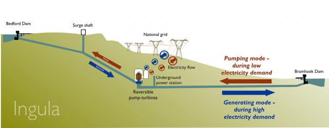

Ingula’s four units are located 350 metre underground in the world’s largest machine hall in mud-rock.
To turn the more than 500 ton rotating mass of the generator rotor and turbine, water is released from Ingula’s upper dam, Bedford Dam, situated 460m higher and two kilometres away.
Water rushes down to the turbines at around 60km per hour with enough water passing through each turbine to fill an Olympic-sized swimming pool in six seconds. Rotating at 428 revolutions per minute, each unit will produce 333 MW, a total for the station of 1 332MW.
