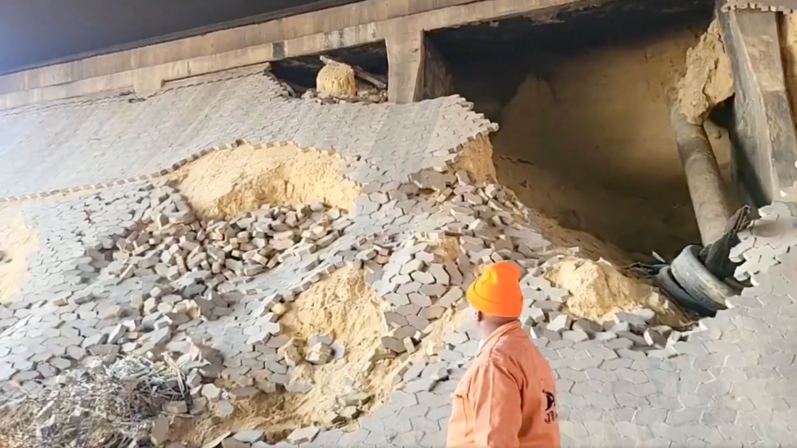

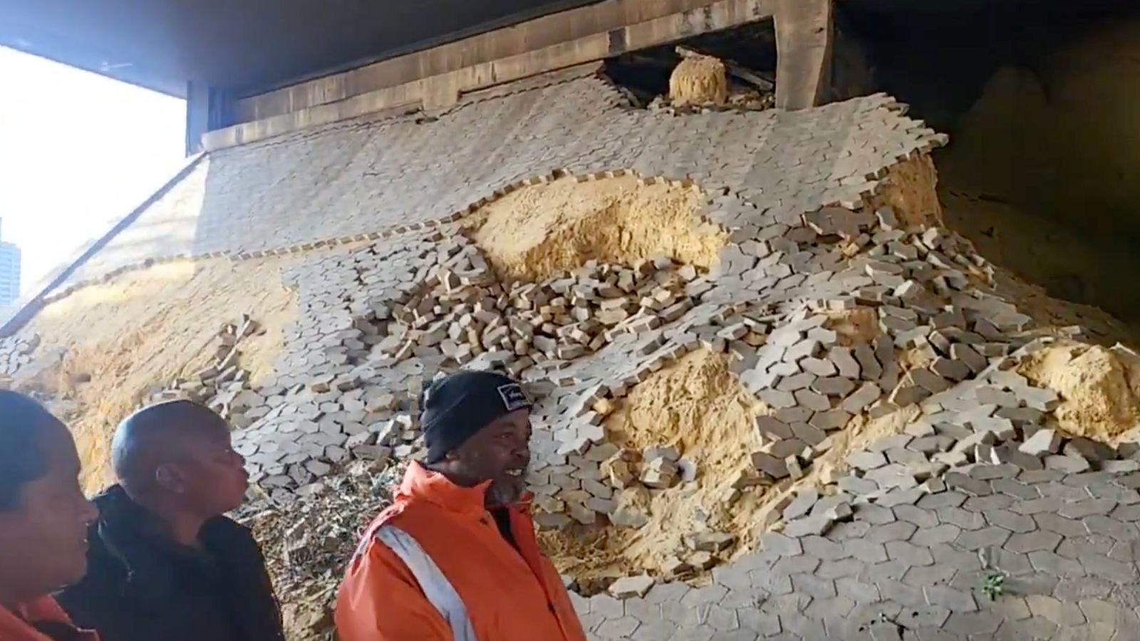

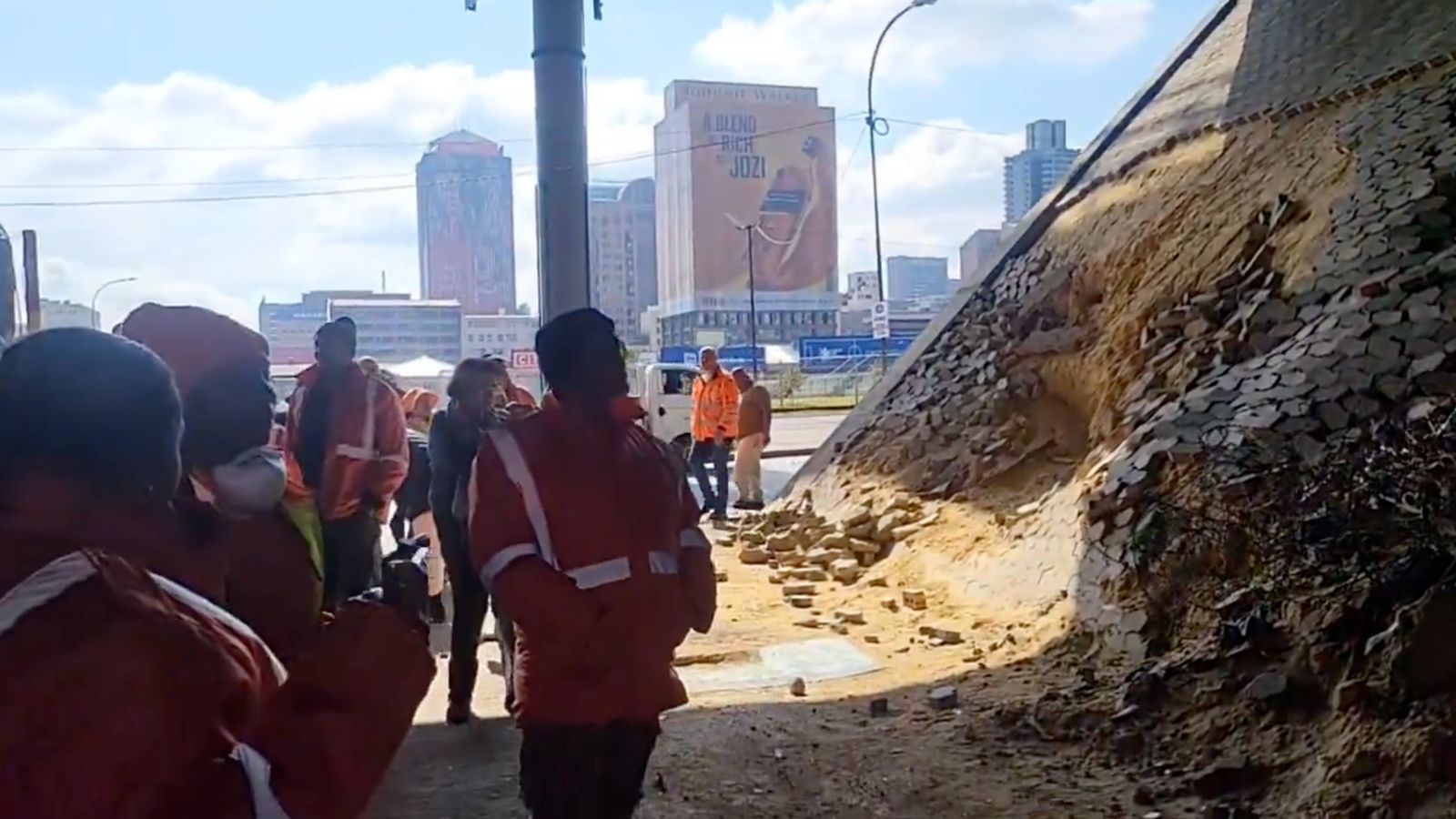

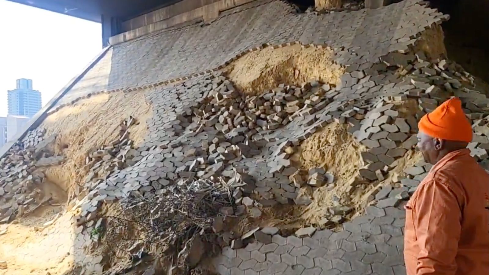

This followed what officials described as“an alarming number of people living beneath the structures and evidence that material was being removed from around their foundations.
“Yesterday we embarked on an assessment, especially of the infrastructure around M1 and M2,” Nyathi said.

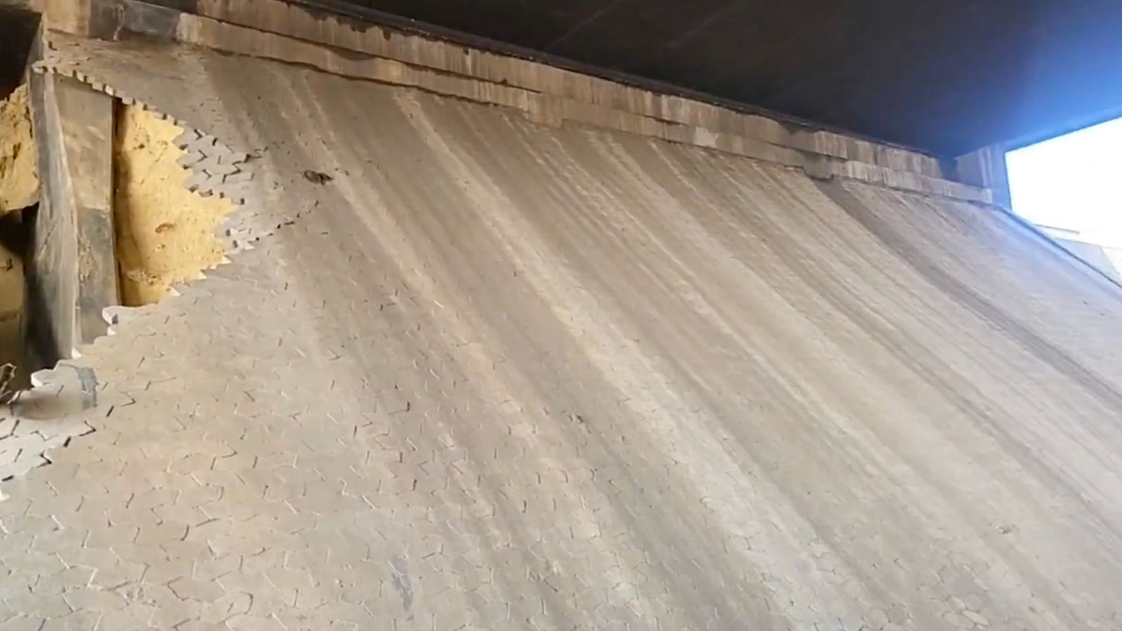

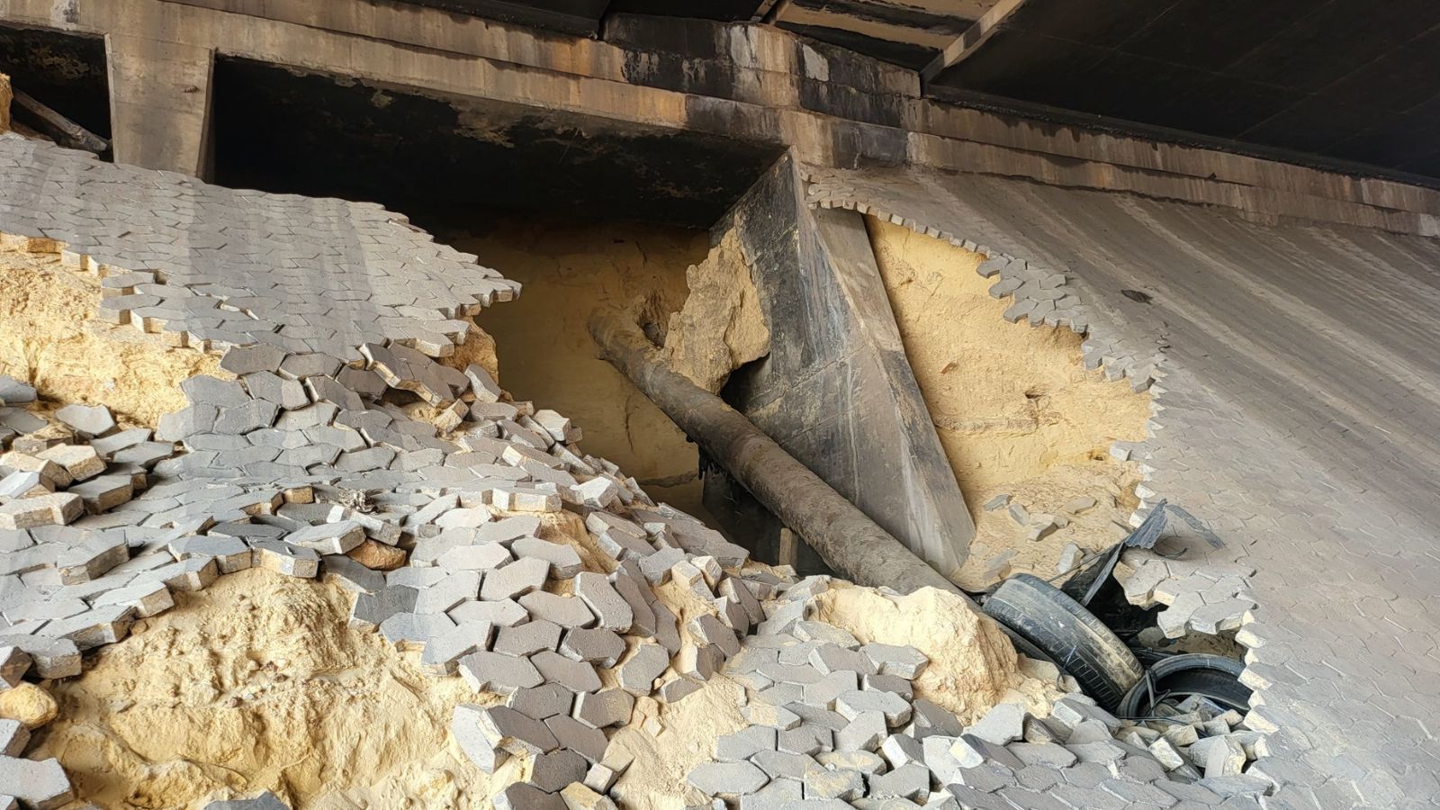

“We have seen that some bricks are now missing, and they’re starting to even mine the sand, which is part of the embankment and support structure of the bridges.”
He explained that the inspection covered multiple bridges rather than a single site, including structures near End Street and Anderson Street on the M2.
While images of the excavation have raised fears that the bridges could collapse, Nyathi stressed that engineers who accompanied the inspection found the structures themselves remain safe for now.
“The bridge itself, the support structure is the pillars and the steel rods that are beneath the surface,” he said.
“The structure itself is still intact. It’s just that if there is this continuous digging, the vagrants might end up now wanting to cut the steel and other things and go underneath.”
Nyathi said officials also discovered people living in excavated holes beneath the bridges, where they could access underground infrastructure and services.
“There are some people who are staying in the holes, and on those bridges, it makes it easy to access some of the networks or services underneath the city,” he said.
“I can assure the citizens that the bridges are structurally sound. We had a lot of engineers with us yesterday, but the continuous excavation and damage might lead to infrastructure collapse. So that’s what we’re trying to avoid.”

He acknowledged that the extensive excavation appears to have taken place over a significant period.
“The infrastructure is under attack there. It’s not only just the bridge; they’re looking for cables, and there are guardrails missing on top,” Nyathi said.
The JRA has already deployed teams to carry out urgent mitigation work after identifying immediate safety risks, including missing guardrails that could cause vehicles to leave the roadway.

Damage to M2 Bridge – photos
