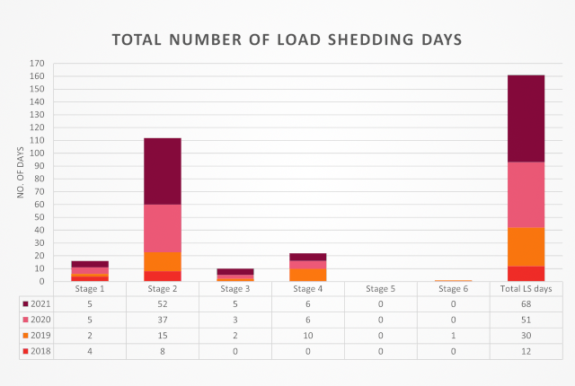

Eskom’s ageing fleet of power stations and unplanned outages have hurt the power producer’s generation capacity for years and these constraints remain a key challenge for future growth.
Figure 1: Trend of increasing days of load shedding (Source: Absa RBB Sectors)
Increasing load shedding days since 2018 highlights the challenges that Eskom faces – a constrained power system, with old unreliable and poorly maintained generation fleet as well as the need for new generation capacity.
The risk of load shedding will remain until substantial new power capacity is invested in.

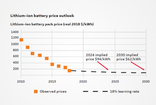

The decline in prices of batteries (in this case lithium-ion), as well as their benefits at times of load shedding, have made for a stronger business case.
Figure 2: Lithium-ion price outlook (Source: Bloomberg New Energy Finance)

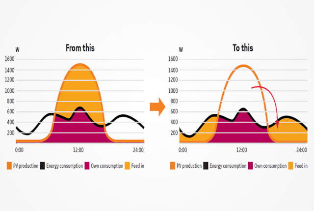

Increased PV self-consumption
The challenge with renewable energy, including PV panels, is that resource availability (e.g. the sun) does not always coincide with demand.
This is especially problematic for residential or commercial customers, who are often not allowed to supply their excess PV energy back to the utility (generated when there is more solar supply than demand at their premises).
BESSs allow these customers to save this excess PV energy for later use (illustrated in figure 3), increasing these customers’ consumption of their PV energy.
Figure 3: PV self-consumption. Source: www.redelectrical.co.uk

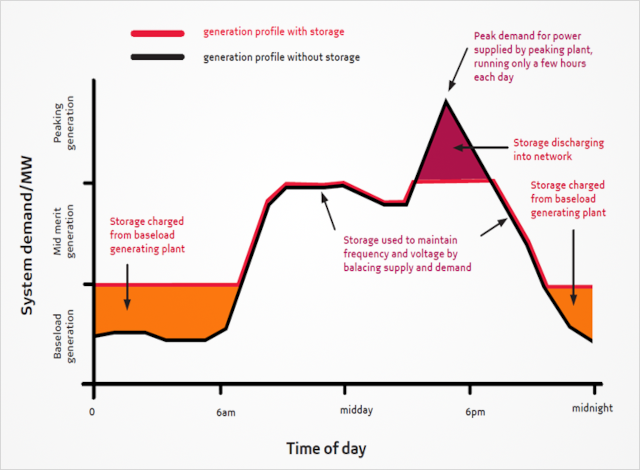

Peak shaving
As the demand for energy increases so too does the cost of delivering this energy.
Often the country’s demand is so high, that “peaking generation” units, such as gas turbines, need to be used to meet demand.
Because of the costs of running these “peaking generation” units, electricity tariffs during these “peak” times are higher than during “off-peak” times.
As shown in figure 4, shaving this peak, through businesses and households discharging their energy stored in batteries to supply their peak needs, can be beneficial to both the utility (which saves on expensive fuel) and the end customer (who saves on monthly electricity costs).
Figure 4: Peak shaving application for BESSs. Source: EE Publishers

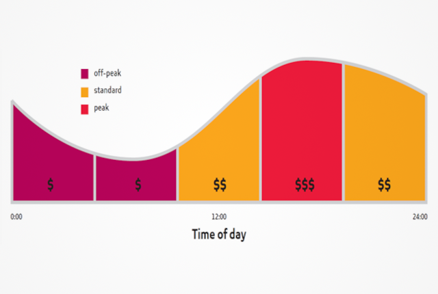

Arbitrage
The value of energy, as with any commodity, is inherently linked to demand.
The higher the demand, the higher the price of energy.
This pattern can be capitalised by charging a BESS during low-demand periods at a low cost and selling the stored energy at a competitive price during high-demand periods.
This is illustrated in figure 5 – the maroon zone indicates low energy prices and the red zone indicates high energy prices.
The difference between the two gives the value that can be obtained.
Figure 5: Arbitrage cycle for BESS, demonstrating a value extraction opportunity. Reconstructed from: energystorageconsultants.com
