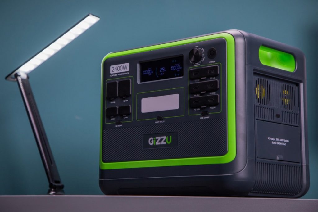

Gizzu gave us the chance to try out its Hero Pro portable power station, and we were impressed with its capacity to handle electricity-hungry appliances during load-shedding.
This is thanks to its huge 2,048Wh Lithium Iron Phosphate LiFePO4 battery, which offers up to three times the charge cycles supported by traditional lithium-ion batteries.

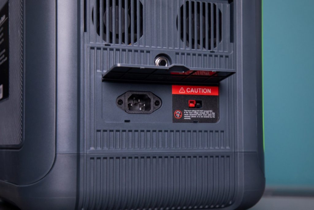

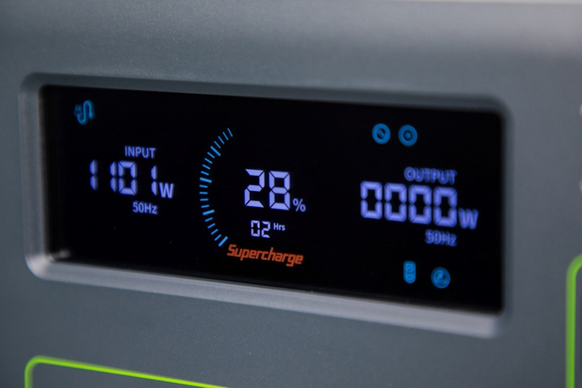

We were also able to confirm Gizzu’s claim that its LiFePO4 battery could charge from 0-100% in under two hours – which was especially useful for getting it ready between loadshedding.

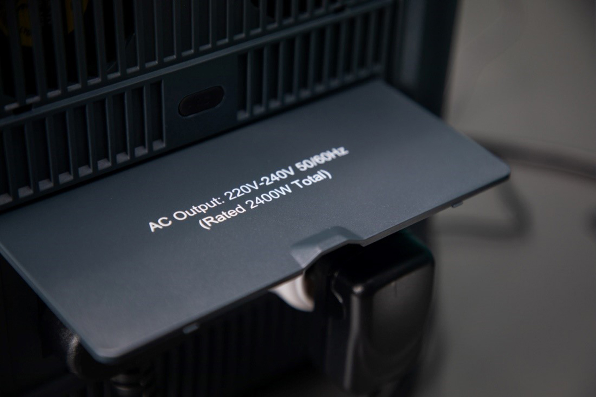

The Hero Pro handled it all thanks to its large battery and support for 2,400W output power – which can also support intensive machinery like circular saws and fridges.

The Hero Pro features a compact design, weighing only 22.5kgs, and easily fit in your boot to be transported to events or trips.
You will benefit from the design most commonly when you want to move this power station around your house, as we found it easy for a single person to carry this portable power station to different parts of our office.
