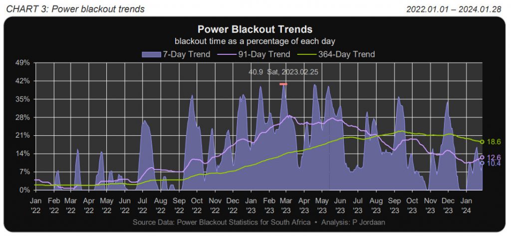

The latest power blackout statistics compiled by independent energy analyst Pieter Jordaan shows that South Africa’s power situation continued to deteriorate in the fourth week of the year, with full power available only 16% of the time.
2024 has started off with a declining trend in power availability, with fading suspensions pointing to Eskom more frequently being unable to meet demand – despite demand being at record lows.

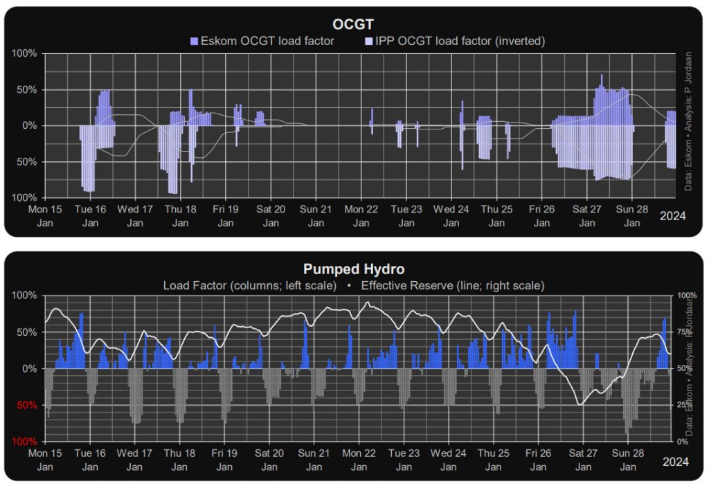

This was seen over the past weekend when Eskom had planned to suspend load shedding, but was quickly forced to implement permanent stage 2 load shedding at short notice as capacity dropped.
Jordaan said Eskom would have been well aware of this eventuality because, by Friday, it had already run down its pumped storage reserves to 25% and had to rely on independent open cycle gas turbines (OCGTs) for two days solid at a load factor of 70%.
“Eskom had skimped on its own diesel generation due to the depletion of its fuel budget – but was forced into action to try and replenish the critically low pumped storage reserves,” Jordaan said.
This means that the 55 GWh, of pumped storage via diesel generation, on Friday and Saturday at R10/kWh, caused a minimum of R7/kWh loss to Eskom – equating to R385 million, which the company may try to recoup in future tariff hikes.
