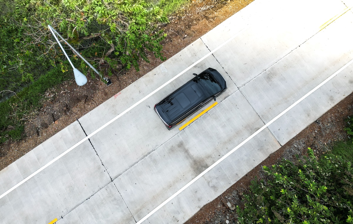

One option is concrete, which is more durable and requires less maintenance than asphalt, making it an attractive option for roads, particularly in rural areas.
However, concrete is more expensive to pour and produces more road noise.
Despite these drawbacks, its longer lifespan could offset the initial costs and maintenance needs, making it a potential solution for South Africa’s rural roads.
