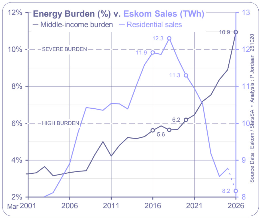

Jordaan looked at South Africa’s electricity expense-to-income ratio, often referred to as energy burden to track the percentage of a household’s income on electricity costs.
“A household is considered to have a high energy burden if this ratio exceeds 6% of their income, and severe if it exceeds 10% of their income,” he said.
“Beyond a 6% burden, households start to limit their electricity consumption to match their income growth, or look for cheaper substitutes such as wood, paraffin, gas or solar power.”

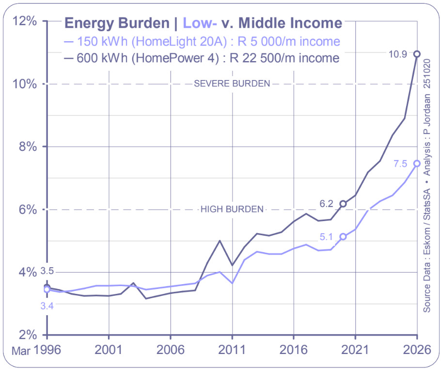

He assessed the energy burden between 1996 and 2025 using two profiles:
- Low-income Households (LIH), with an income of R5,000 per month, consuming 150 kWh/m on Eskom’s HomeLight 20A tariff.
- Middle-income households (MIH), with an income of R22,500 per month after tax, consuming 600 kWh/m on Eskom’s HomePower 4 tariff.
According to Jordaan’s calculations—based on Eskom’s own data and official figures from Stats SA—up to March 2008, LIH carried an energy burden of ten basis points higher than MIH.
In 2008/9 and 2025/6 Eskom restructured its retail tariffs so aggressively, that by 2025/6 MIH now carry a burden that is 340 basis points higher than LIH.
By 2020 the energy burden for MIH had escalated from 3.5% to 6.2%, which is considered a high burden.
Eskom restructured its fixed charges substantially in 2025/6, having the effect of increasing the energy burden for MIH by 22% from 8.9% to 10.9%, creating a severe burden.
Jordaan warned that this will only get worse.
Because Eskom’s tariff restructuring in 2025 is phased—with only 20% of the change kicking in this year—the tariffs will escalate steeply in 2026/7 and 2027/8 as more fixed charges are phased in.
Based on the Nersa-approved increases, the MIH energy burden is set to reach 14.7% by 2027/8.

After two consecutive 30% price-shocks in 2008/9 and 2009/10—exacerbated by the global financial crisis—demand stopped growing for five years.
“Eskom seemingly realised that the increases stifled demand and slashed its tariffs by 10% in 2011, which only marginally stimulated demand. Economic growth returned in 2014-16, so did demand and load shedding,” Jordaan said.
As South Africa’s energy burden increased, demand started tanking. Recent spikes in demand are due to load shedding effectively ending, but remain far from that seen in the past.

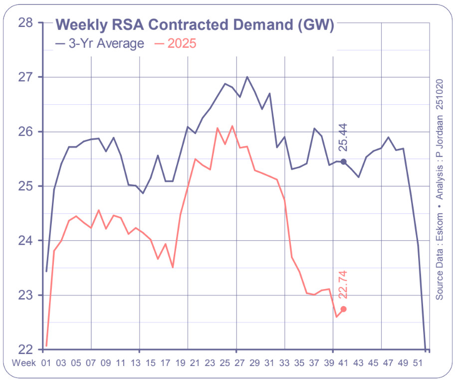

In fact, “from 2019 onwards, Eskom residential demand started to freefall,” Jordaan noted, with Eskom’s residential demand being in decline at a compound rate of 5% per year.
In 2025 a “spike” of less than 0.1 GW was observed and overall demand has not yet bottomed out.
“This is a clear indication that demand for Eskom’s power has taken a severe hit; and historic data shows that demand losses are permanent from 2018 onward due to the overpricing of its product,” Jordaan said.
