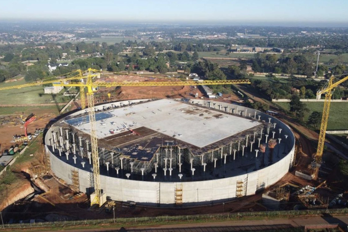

HKG Consulting, which was involved with the project, noted some technical aspects of the build:
The reservoir has an inner diameter of 154 metres and a wall height of 11.8 metres. The reservoir is covered by a flat slab roof supported by 256 columns spaced at 8.4 metres.
“Since the reservoir is 6 metres below natural ground level, both a leakage detection system and a ground water drainage system, separated by a reinforced flexible polypropylene liner, is provided underneath the complete footprint of the reservoir,” the group said.
Construction on the reservoir started in 2015, with the official completion date targetted for mid-2023.
“This is probably one of the largest cylindrical post-tensioned concrete reservoirs in the world,” it said.
