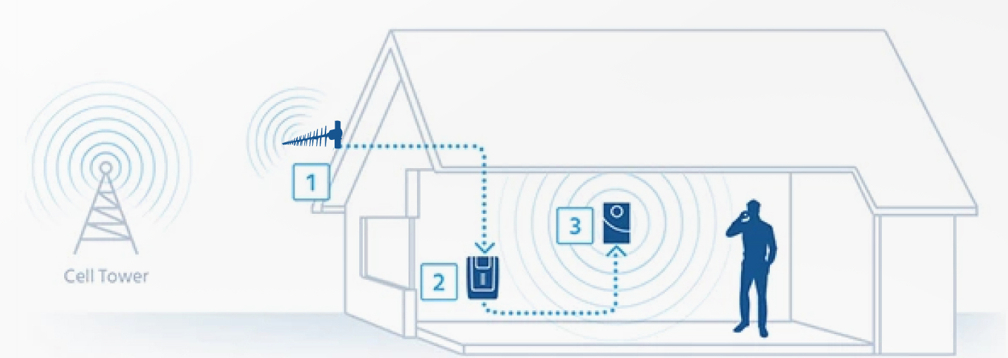

The below image explains how cellular boosters work.

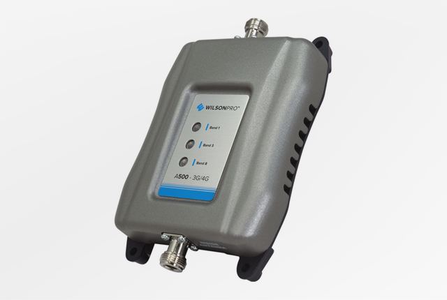

Some of the most popular WilsonPro products that are available from Bolton Technical and Inteto Connect include the following:
Typical Home Size up to 500m2 – WilsonPro A500
The WilsonPro A500 is a 50 Ohm cellular booster that boosts voice and text, as well as 2G, 3G, and 4G data.
The A500 offers coverage for your typical home size of up to 500 square metres, and can be used with all of your cellular devices across any of South Africa’s mobile networks.
Supported devices include smartphones, tablets, notebooks, and hotspots.
The WilsonPro A500 is the most popular choice for home usage due to its affordable price point and impressive performance.

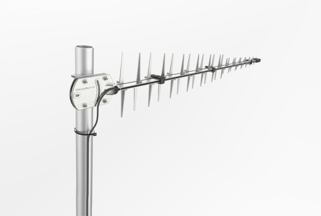

Choosing the right antenna
WilsonPro’s cellphone boosters can be used with various Poynting antennas, and the choice of which antenna to use will depend on your specific situation and requirements.
There are two main types of antennas – Omni antennas and directional antennas.
Omni antennas can work with cellular signal coming from all directions, which is great if you’re in an area that has multiple base stations within range. This is because if one base station is offering poor signal, you can instead automatically get signal from a different station.
It is also easier to install than a directional antenna as you don’t need to work out the exact direction of a base station for it to operate efficiently.
This also means that you won’t need to readjust your antenna if a site is shut down, or if a new, closer site is developed.
The downside to this antenna type is that it is less efficient, and offers slower throughput, in undercovered areas.
Directional antennas focus on one specific direction, which results in improved connectivity from sites at which it is pointed.
This makes it a great choice if you only have a single site in range, and if the quality of signal is not great – as you will be able to get better reception from weaker sites.
However, it is more difficult to install, as it needs to be directly aligned with the targeted cell tower, and if this tower suffers issues, you will not be able to switch cell towers without manually adjusting the antenna.
It is worth noting that it is possible to combine both omni and directional antennas into a single MIMO configuration – which will lessen the disadvantages of both antenna types.
