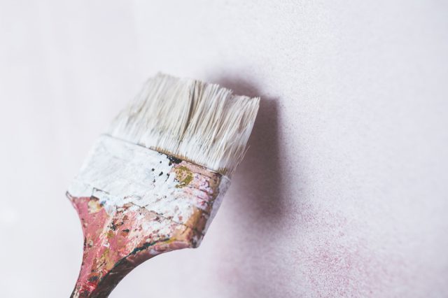

Random patches of fresh paint
A coat of paint is undeniably one of the quickest and most effective ways to spruce up a home but if only portions of walls or ceilings appear to be painted, it’s definitely not to be ignored. It’s possible the seller is trying to cover up a problem such as damp, which should be a cause for concern.

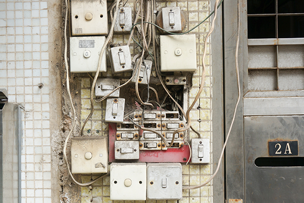

Electrical wiring
“It’s typical to see extension cords running from room to room in older homes. which places a burden on the electrical system, outlets and cords and thus could lead to a fire,” said Geffen.
Another common electrical problem is exposed electrical wires, often the result of DIY repairs. Any wire that is exposed is susceptible to physical damage and if this occurs, it’s sure to wreak havoc. This is high priority and should be corrected by a licensed electrician.
