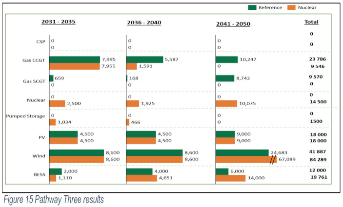

Under the draft 2023 IRP, the DMRE has not indicated any additional nuclear energy contributions through the end of its first ‘horizon’ of 2030.
However, in the 2030-2050 horizon, a mix of new generation sources is listed, including nuclear.
The future build pathway that embraces nuclear includes a 2,500MW build in 2031-2035, further nuclear procurement of 1,925MW to the end of 2040, and a massive 10,075MW by the end of 2050.
