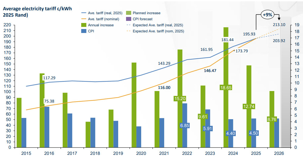

Electricity prices are bleeding South Africans dry
Another crucial factor hitting demand is higher electricity prices, which are pushing customers away.
The CSIR noted that Eskom’s tariffs are going up and exceeding inflation, with the national average tariffs having risen 190% since 2014.
“Increases in the price of electricity prior to 2008 were mostly below inflation. Electricity prices increased significantly in 2008, which coincided with the start of load shedding,” the CSIR said.
The national average electricity tariff increased by an average of 10% per year from 2014 to 2025, compared to an average inflation rate of 5.2% over the same period.
With the projected 2026 hike of 8.76% again exceeding the 4.5% Consumer Price Index forecast, the trend is not slowing down.
Notably, the CSIR pointed out that Eskom’s electricity tariffs are now above the utility‑scale solar photovoltaic levelised cost of electricity.
The implemented NERSA tariff increase of 12.74% this year takes the average tariff to c/kWh 195.93. The proposed tariff escalation of 8.76% will increase the national average tariff to 213.92 c/kWh in 2026.
This is compared to the levelised cost of renewable generation resources, which range between 50 c/kWh and 60 c/kWh for solar PV and wind utility-scale power plants in the REIPPP programmes, the CSIR said.
