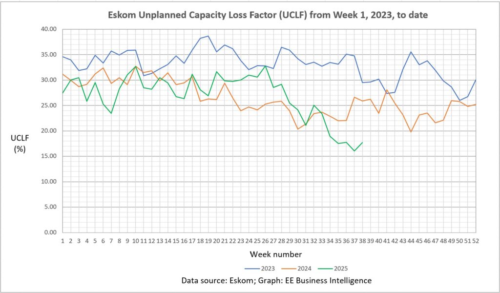

Between 19 and 25 September 2025, Eskom recorded an average of 9,514MW in unplanned outages, a significant improvement compared to 12,660MW during the same period last year.
This represents a year-on-year reduction of 3,146MW in breakdowns, nearly equivalent to the entire output capacity of Duvha Power Station.
This upward trend demonstrates increasing stability and improved reliability across Eskom’s generation fleet.

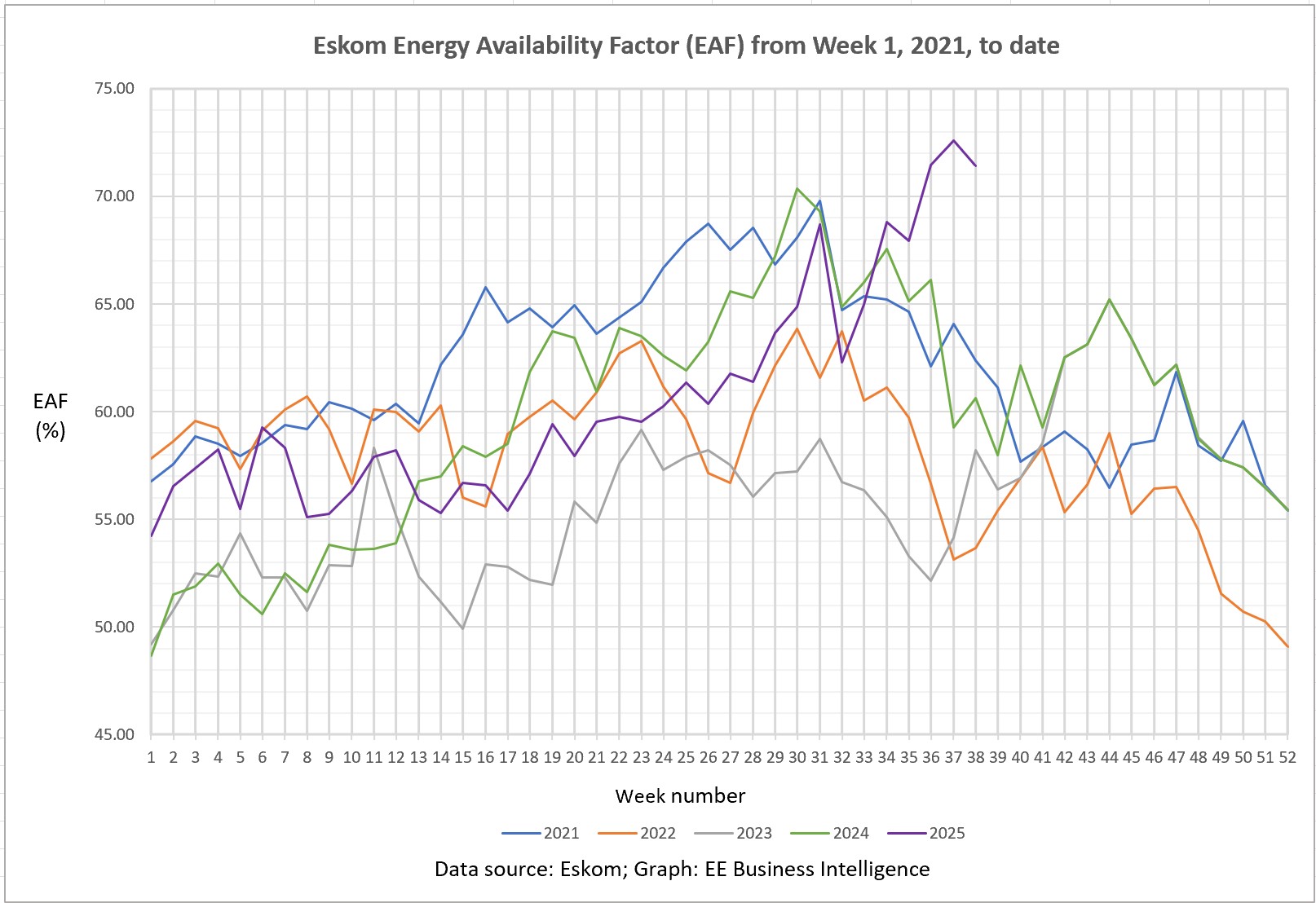

Eskom’s energy availability factor (EAF) fluctuated between 65% and 71%, with the month-to-date average holding above 70% at 71.15%. The last time it trended this high was in 2021.

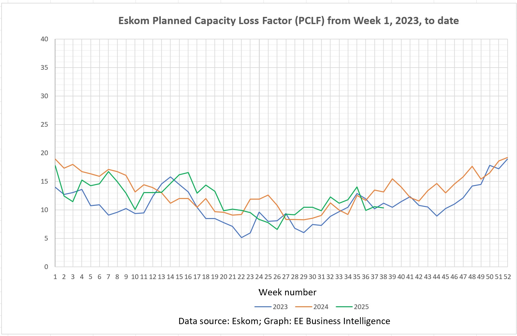

Energy analyst Chris Yelland said Eskom’s EAF has risen to levels significantly higher than those of the last four years and 12 percentage points higher than in the same period in 2024.
“Planned maintenance outages are three percentage points lower and unplanned outages are eight percentage points lower than for the same time last year,” he said.
“This is a very significant and dramatic operational performance improvement indeed. Well done to the Eskom Generation team led by Bheki Nxumalo.”
Eskom performance improvement
The charts below, courtesy of Chris Yelland, give Eskom’s week-on-week energy availability factor, planned maintenance outage (PCLF) and unplanned outage (UCLF) trends.
